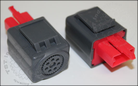

FigJam-OhNine Posted January 16, 2015 Author Share Posted January 16, 2015 Okay, installed this Electronic Flasher Relay today in preparation for LED install. Same size, shape and connector as OEM. Works fine with stock incandescent flashers or replacement LEDs. Adjustable flash rate too. Perfect replacement in 5 mins. LED Flasher Relay Just grabbed a relay from my dealer. Worked like a charm. Link to comment Share on other sites More sharing options...
