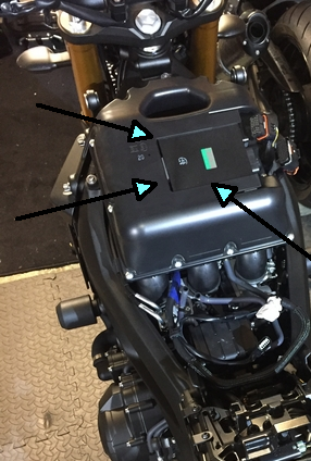

How2 Posted November 10, 2018 Share Posted November 10, 2018 Hello I do have the book and really don't want to tear into anything right now. Does any one have a photo of the ECU location? That would be helpful, anyone. Thanks H2 Link to comment Share on other sites More sharing options...

Premium Member duhg Posted November 10, 2018 Premium Member Share Posted November 10, 2018 Under the fuel tank and on top of the airbox. https://ridemsta.com/oh-tmr/ Riding makes me happy. "Do it or don't do it - you'll regret both." - Soren Kierkegaard 2015 FJ-09, 60k miles, Hord Power ECU, K-Tech suspension, MC Cruise Link to comment Share on other sites More sharing options...
duhs10 Posted November 10, 2018 Share Posted November 10, 2018 @how2 it's not as difficult to get to as one would think... just have to remove a bunch of plastic and the tank (or just turn it out of the way) '15 FJ-09 w/ lots of extras... Fayetteville, GA, USA Link to comment Share on other sites More sharing options...
rain Posted November 10, 2018 Share Posted November 10, 2018 STOP Don't remove the tank. Take off the right side plastics. Tilt the tank up, support it with beer cans, blocks of wood, whatever, you'll figure it out. The ECU slides out from right side easily. You don't have to dis-connect anything from the tank. This applies to the 15's to the 17's. Link to comment Share on other sites More sharing options...
Supporting Member betoney Posted November 10, 2018 Supporting Member Share Posted November 10, 2018 STOP Don't remove the tank. Take off the right side plastics. Tilt the tank up, support it with beer cans, blocks of wood, whatever, you'll figure it out. The ECU slides out from right side easily. You don't have to dis-connect anything from the tank. This applies to the 15's to the 17's. Wha?? To tilt the tank up you must remove the left AND right side plastics. You have to remove ALL of the plastics mounted to the tank. The only thing you dont need to remove is the fuel line, electrical connector and vent hoses on the bottom of the tank. ***2015 Candy Red FJ-09*** Link to comment Share on other sites More sharing options...
