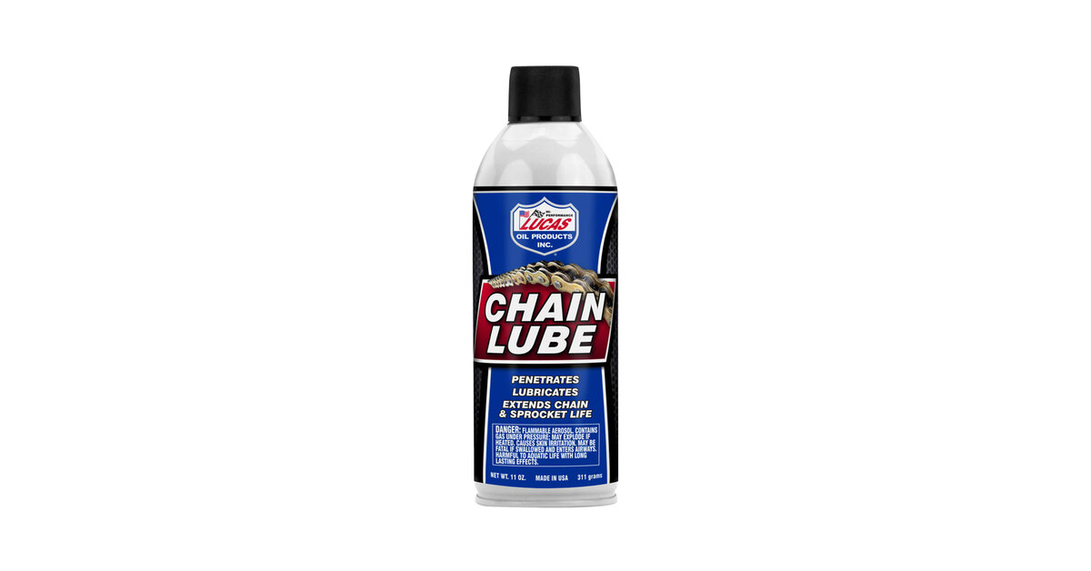

Premium Member fddriver2 Posted October 30, 2020 Premium Member Share Posted October 30, 2020 I've been using PJ1. I picked up some Lucas chain lube while on my Murphy road trip. Because I misplaced my little can of PJ1. Worked pretty good and didn't fling... Much.... YMMV Lucas Oil 10393 11 oz. Chain Lube Aerosol Shop Lucas Oil 10393 11 oz. Chain Lube Aerosol. In stock at a low price... "It doesn't matter who walks in, you know the joke is still the same" Ft. Lauderdale, Florida. USA Link to comment Share on other sites More sharing options...

johnmark101 Posted October 31, 2020 Share Posted October 31, 2020 3 hours ago, fddriver2 said: I've been using PJ1. I picked up some Lucas chain lube while on my Murphy road trip. Because I misplaced my little can of PJ1. Worked pretty good and didn't fling... Much.... YMMV Lucas Oil 10393 11 oz. Chain Lube Aerosol Shop Lucas Oil 10393 11 oz. Chain Lube Aerosol. In stock at a low price... I like PJ1 Blue Label and have used it for years with good results. Usually get a little over 20,000 miles from a chain.........except for the crappy OEM chain that this bike came with. I have heard good things about DuPont Chain Saver but have yet to try it. 1 There is nothing like spending a day riding with friends in the grip of a shared obsession. Link to comment Share on other sites More sharing options...
